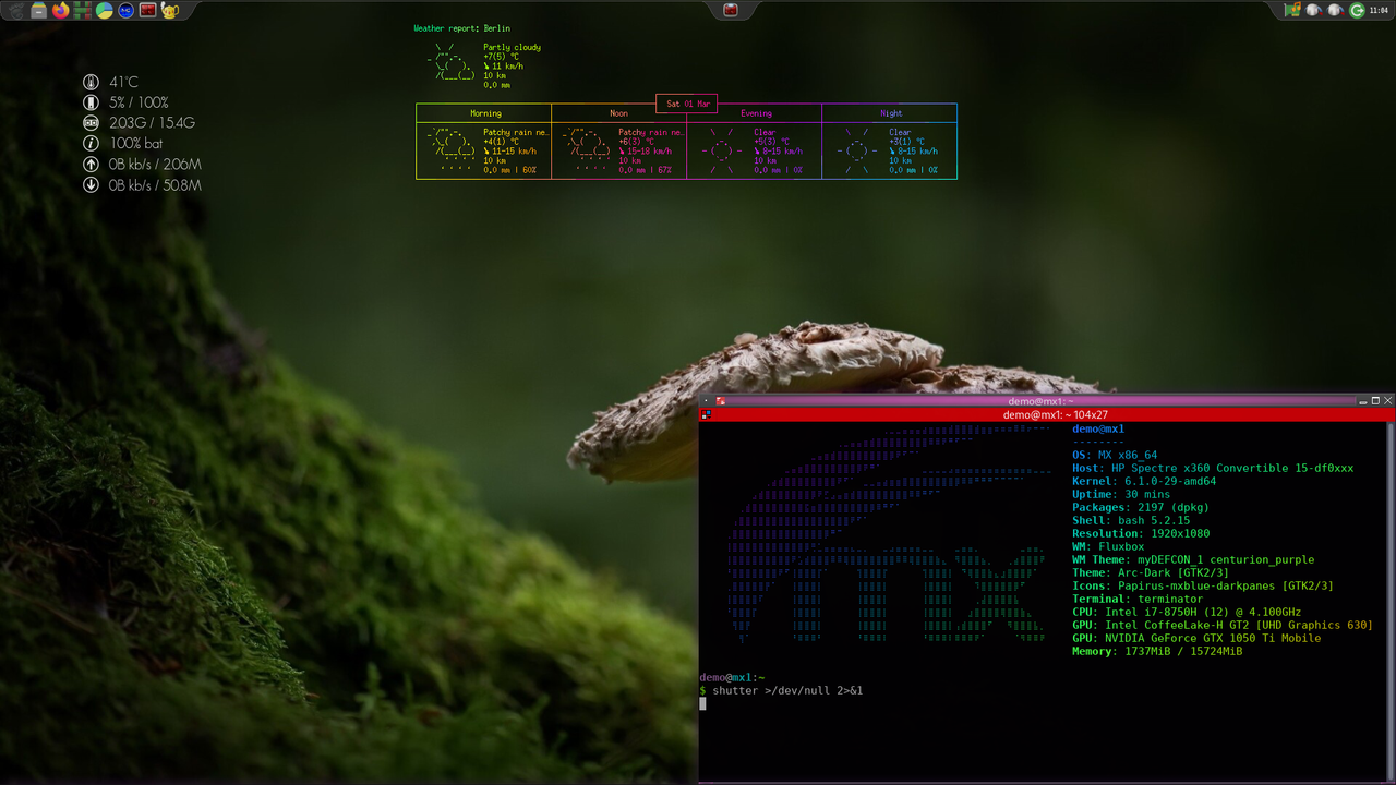

Hi Jerry,
i gave it a shot i think i got it right now but i am by no means a conky specialist :).
it looks like that atm: https://i.postimg.cc/26Y2XsRm/Desktop4-001.png

Will this work?
If so, these are the changes I made.
conky.text section
Change the white line size so that it matches closer to the icons.
from this
${image ./images/whiteline.png -p 350,27 -s 3x180}${color0}
to this
${image ./images/whiteline.png -p 350,27 -s 3x170}${color0}

Took a look--the battery icon change is great! Not sure yet about the line length, I had actually intended it to be a bit longer that the icon row but will think about it some more.
Open still from my OP is the vertical spacing of the text to the right of the icons. On close inspection it can be seen that the top 3 lines are not quite in line with the icons, whereas the bottom 3 are. I tried making little adjustments on the {voffset} values but it kept getting worse. It'd be great if anyone can figure out how to fix that.
Production: MX-23 Xfce, AMD FX-4130 Quad-Core, GeForce GT 630/PCIe/SSE2, 16 GB, SSD 120 GB, Data 1TB
siamhie
Posts: 3714
Joined: Fri Aug 20, 2021 5:45 pm
Re: conky vertical spacing adjustment
#10 Post by siamhie »
Jerry3904 wrote: Sat Mar 01, 2025 2:02 pm Took a look--the battery icon change is great! Not sure yet about the line length, I had actually intended it to be a bit longer that the icon row but will think about it some more.
Then change it.
I only selected 150 to keep everything lined with the icons. (my OCD)
${image ./images/whiteline.png -p 350,27 -s 3x150}
The first set of number represents the location. (-p position) starting from the top left corner of the screen).
-p 350,27
The second set of numbers represent the size. (width/length)
-s 3x150
Just change the values back to the original (-s 3x180)
