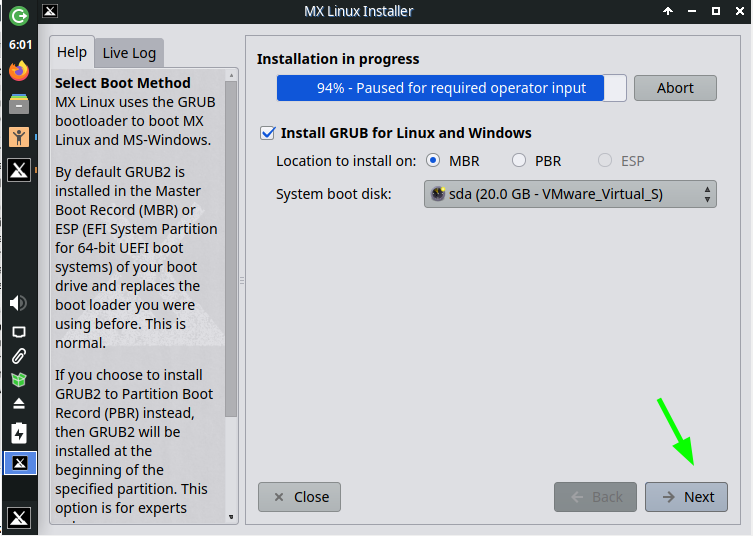

Re: kernel updates not appearing (until grub repair tool used)
The issue is about: When you boot int MX-23 and install/upgrade a new kernel, "update-grub get's triggered and generates a new grub-menu including the new kernel entry. This GRUB menu is located in the MX-23 /boot/grub/grub.cfg.
But this GRUB menu will only be "displayed" / "shown" after reboot, if you choose the GRUB bootloader which relates to the MX-23 installation.
So if you just reboot/power on, and you have choosen to boot int the GRUB bootloader of the MX-19 installtion,
the GRUB menu on MX-19 does have now "idea" what was done on MX-23.
The GRUB menu on MX-19 is located on the partition under /boot used by MX-19 on /boot/grub/grub.cfg,
and is a completely separate grub menu.
So yes, installing a new kernel on on MX Installtions, reuqires to boot into the other installation an regenrate the grub-menu again.
You mention also that you cannot select something within MX Boot Repair when booted into MX-23, but trying to re-generate
the GRUB menu on MX-19. This may be related to /etc/fstab on MX-19 or something else.
But maybe you show some pictures, what is actually not working.
OK, the main point was about when in MX-23 a new GRUB menu get genrated, it will only be seen
when you also boot into MX-23 generated efi GRUB loader, not when you boot int the MX-19 efi grub-loader.
During Boot up you can with e.g F12 (or another F-key select the efi-GRUB loader) select the fi-GRUB loader.
In addition you can set the default "fallback" efi loader, thats the one, if you boot from the "drive",
or incase not efi-loader are stored any more with the NVRAM.
So not sure why you defaults to boot into MX-19 and not in MX-23.
Suggest to chacge this.
Also notr the MX-23 is a minimal (respin) version, and not really supported,
so may well be that something else is missing on this installation, which create surprises.

since this problem was not solved for my laptop, and i am soon doing another mx install for a different machine, am hoping for some further comments.
i suspect the problem arose due to my selection of grub options during the mx23 install (via usb) on a different partition.
(e.g., this step from a generic install website...note, this is NOT my screenshot when i installed)
https://www.linuxtechi.com/wp-content/u ... ebp/ngcb22
i confess i didnt know exactly what grub options to choose here during the mx23 install, and the help sidepane did not seem very guiding.

could it be that my grub choice during the initial mx install (windows dual boot option for mx19) determined what i should have used for grub options when installing mx23 on a different partion?
