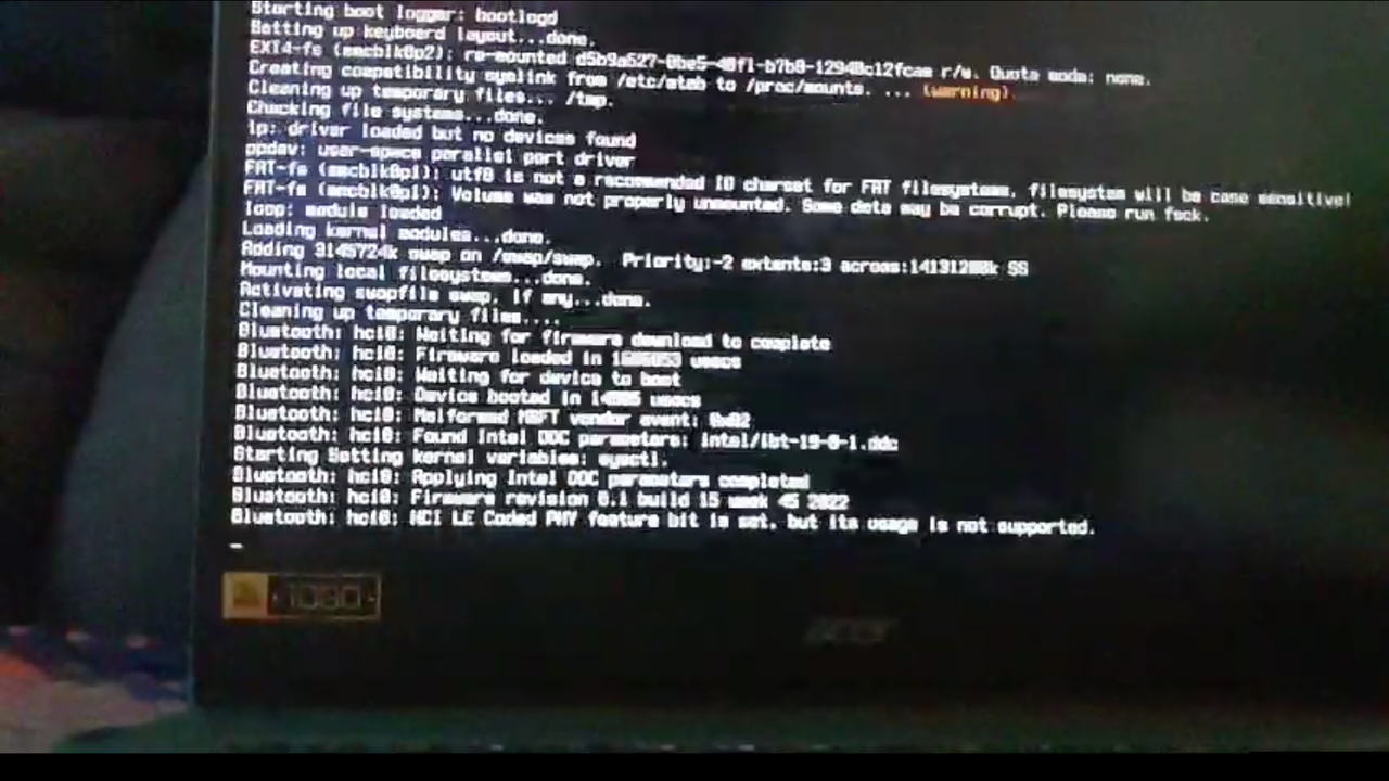

The QSI is from when I first experienced the bug, but it made no difference to the behaviour whether I select the liquorix options in grub or not.
The boot messages go by so fast I had to try to record them on video, best I can tell this is the last frame before the black screen.
https://i.postimg.cc/52sMfcX3/Screensho ... -29-44.png
So nothing obvious, maybe to do with the kernel variables? Could at least point towards where in the process it's happening.

Though it looks weird, "why Bluetooth" ... You can try to disable that service at boot time ("MX Service Manager" from menu) then try what happens with a reboot.

Disabling bluetooth at boot makes no difference.

... So, is there any difference now, where it stops ?

No, still around the same 'starting setting kernel variables: sysctl.' message as before, just without the bluetooth clutter. It kind of looks like it's trying to draw another message after that, but it disappears before my camera can pick it up.
