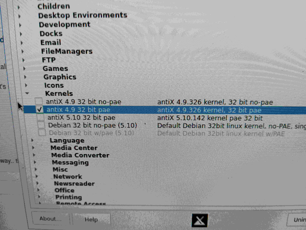

In case you'd like to try another kernel: Chroot again, same way.. then issue:
mx-packageinstaller
..and install antiX 4.19 from the initial tab with 2 clicks..
Before doing this I decided to do a Clonezilla backup so I could try a few things then go back to this checkpoint.
I then installed the older kernel but I didn't see an antix 4.19 kernel but there was an "antix 4.9 32 bit pae" kernel. I assumed the 4.19 was a typo so I went ahead and installed the "antix 4.9 32 bit pae" kernel.
Unfortunately I got the same scrambling screen with this older kernel.

Actually there are both 4.19 and 4.9 here , in fact I was going to suggest 4.9, just didn't for the support ended for 4.9 in general , but you did well trying that.
It may not show the refresh rate of the installed system when chrooted (not sure). However we can see what rate it is on live session and make a script according to that and place it on installed MX's autostart.. Something like:
I only saw 4.9 in my list. I have attached a photo of the screen I got.......
https://i.postimg.cc/hPWtzTbF/Kernels-Screen.jpg
