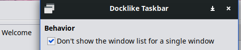

hello PaulGureghian1
closest step in that direction,
regarding it is docklike plug-in that is this subject,
in docklike taskbar Preferences
one small step is to checkmark
[-] Don't show list when single window.
This is about pop-out window list of nonpinned applications.
What percentage of use will that turn-off for You?
Pinned applications will follow the window list rules same as nonpinned apps;
at times the pinned apps are not open and have no window list.
Pinned Applications will always show name on hover
when there is no menu list greater than one.
This is about pop-out Name identity tooltip of pinned applications.

The plugin worked. thanksSwampRabbit wrote: Sun Oct 24, 2021 10:03 pmHey bud, good to hear from you, hope all is good with you.Nite Coder wrote: Sun Oct 24, 2021 8:02 pm I saw this and considered adding an option in the dialog, kinda of like the "Don't show list for single window", but I don't know where to contribute anymore as the https://github.com/davekeogh/xfce4-docklike-plugin seems more up to date and links back to the Xfce Wiki. Where is MX Linux packaging the plugin from?
