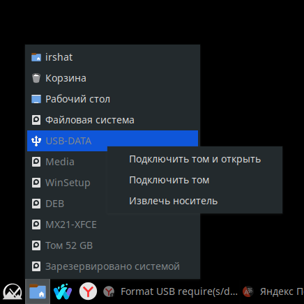

For a quick USB connection, I added a jump button to the panel. It is very convenient to connect and disconnect.
And mx usb unmounter is not needed
[Image
I have a Russian interface, but from the screenshot I think you understood what kind of button I put.
Desktop: KDE Plasma 5.20.5 wm: kwin_x11 dm: SDDM Distro: MX-19.4_KDE_x64 patito feo November 11 2020
