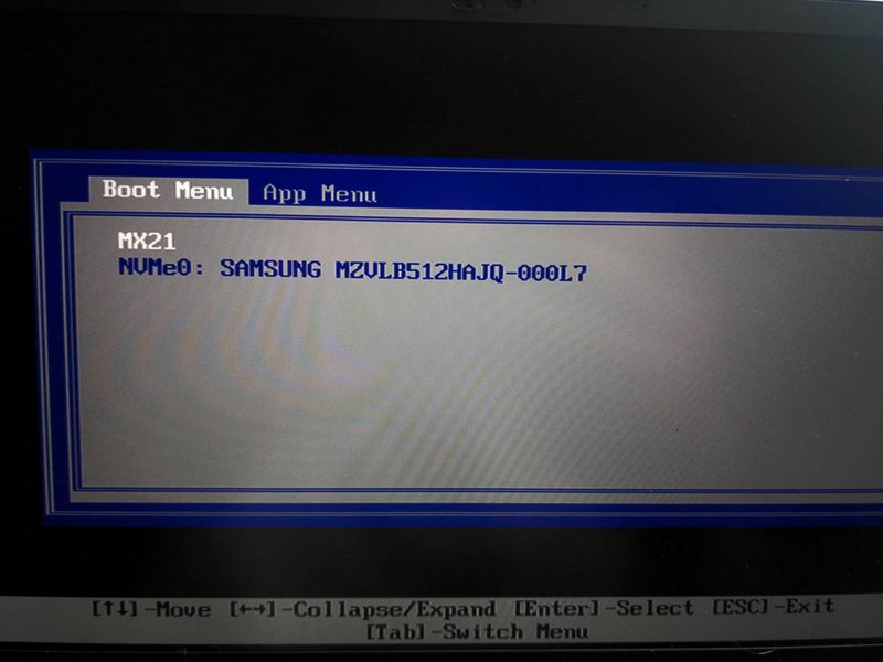

Still i dont have luck...
I need to have 4 partitions
ESP - because of the GRUB install to have ESP
BOOT - otherwise installer wont start
ROOT - same
SWAP - swap
what am i missing?

5. without usb stick i end up with this
https://i.postimg.cc/zXLQq9Gy/2.jpg

Re: installing MX on Lenovo - Boot
and I presume selecting mx21 works or doesn't work?
Live system help document: https://mxlinux.org/wiki/help-antix-live-usb-system/
nothing changes dolphin, you click and it refresh the screen

Re: installing MX on Lenovo - Boot [Solved]
did you ever turn off secure boot?
Thats it! it works, case closed
Disabling this feature, allowed MX to boot normaly,
thank you
