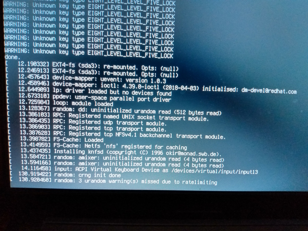

Now, after installing mx19-beta3, there occured a problem on boot:
...the "unknown key-type warning" is 'normal', it's somehow caused by the german "Neo2" keyboard layout, but mx-18 is running just fine with it.. *(and it wasn't there at all in mx17, if I remember correctly)*
However, since the msg at 14.116 was related to keyboards as well, I reinstalled with normal qwerty variant, and voila, all works fine. (Now I just load neo2 after booting..)
==>>Thought I post this here, in case the same error happens for other variants as well?!... ((cuz in 18 all worked, but in 19 it freezes on booting))

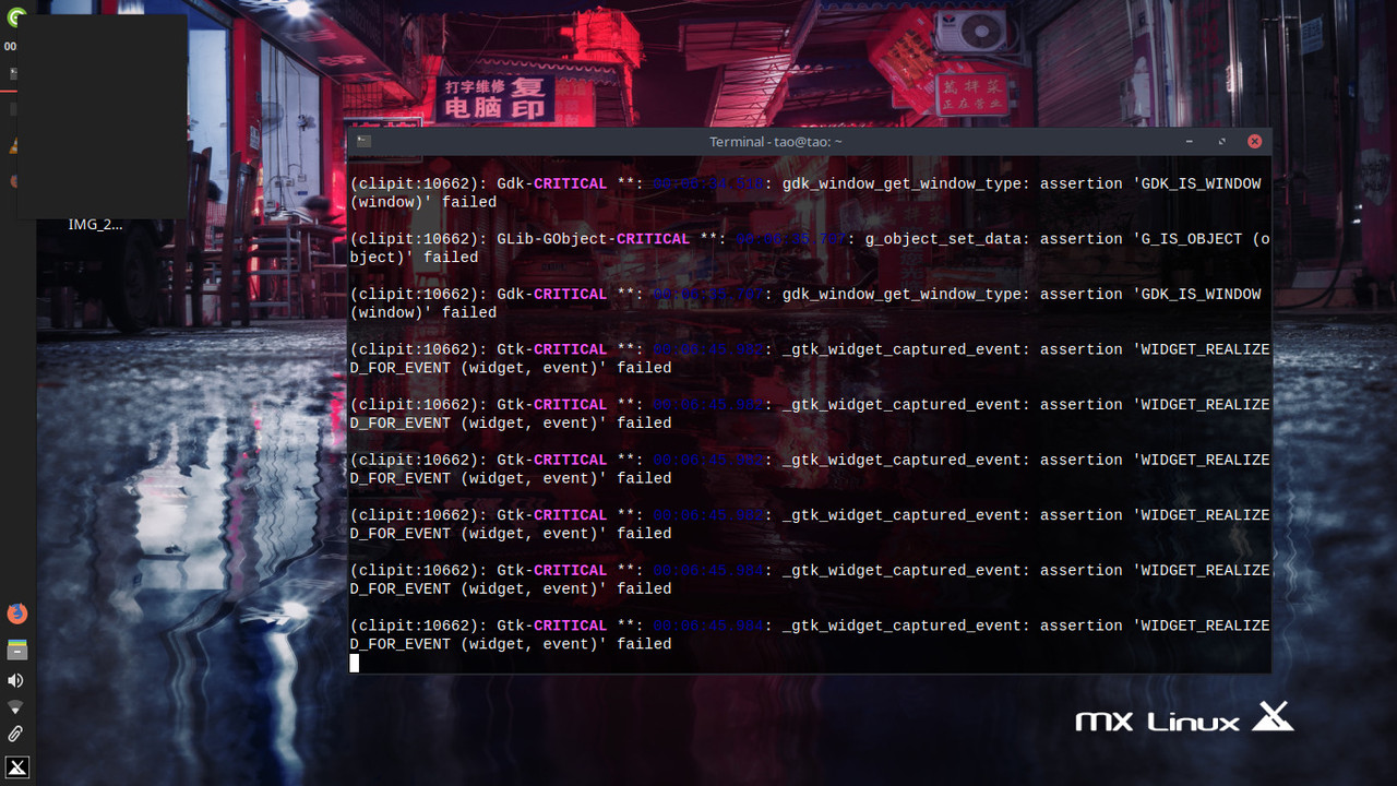

Found a bug :-)
=> Clipit <=
..after pressing the keyboard-shortcut to popup it's history-window at the mouse-curser, the bug occurs. The history window doesn't open, an error shows up when started from a terminal, and henceforth you cannot acces the preferences (or any other context-menu) anymore... doing so just spawns an empty always-on-top 'window' in the upper right corner. It's still working, though, you can click on its taskliste-icon and choose your copied text from the list.
Killing clipit despawns the window up left; you can start it again and access preferences just fine...until you press the keyboard-shortcut; bug is repeatable..
( seems to only happen with the history-shortcut, the other shortcuts seem to work fine..)

yuul wrote: Thu Oct 10, 2019 6:32 pm Found a bug :-)
=> Clipit <=
https://i.postimg.cc/8P6dMFR4/beta19-bugs-clipit.jpg
ugg...a gtk error.
